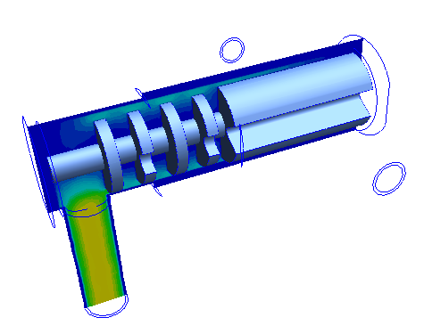

Cutting planes, iso surfaces, and summary points are listed as sub branches. These branches do not support interaction, so they are for informational purposes only.
Suppressed parts are excluded from the simulation. When results are displayed, suppressed parts appear shaded with a uniform color:
By default, suppressed parts are notvisible when you first enter Results. To show them, open the Design Study bar, and expand the Materials branch of the Results branch. Check the box adjacent to each part you want to display.
You can control visibility and appearance in the same manner as active parts.
