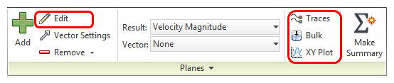

-  On-model Method 1: Left click on the Plane, and click the context toolbar icon.
| Settings (Controls) Traces XY Plot Bulk
-  On-model Method 2: Right click on the Plane, and select from the menu.
-  Off-model: Click the icon in the Planes context panel.

- Right click on the plane, and click Summary.
- Click Make Summary on the Planes context panel.
