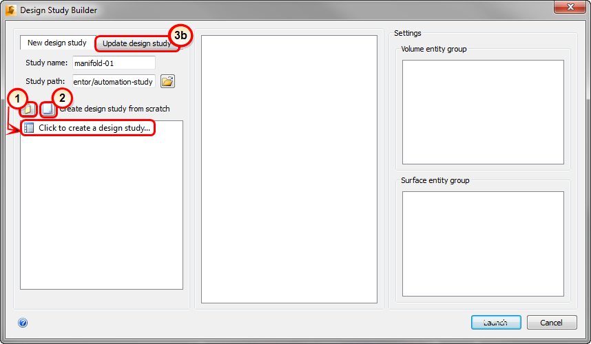

There are three ways to define the design study:
- To define all settings, click the New icon, and Click to create a design study....
- To use a Template, click the Template icon. Browse, and select from the list.
- Add a design to an existing design study: - Create a new design variation in your CAD system. Open the Design Study Builder.
- Click Update design study, and select the design study to modify.
- Clone a design in the Design Study Builder, and associate the new CAD design with the cloned design (as described below).

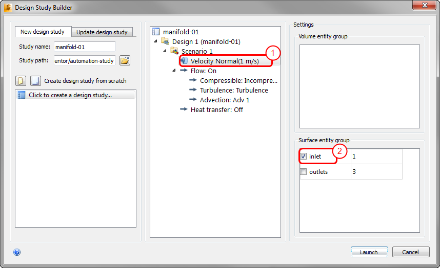

To Create Settings
- Right click on the scenario branch, and select the type of setting.
- Specify the values in the quick edit dialog.
Assign Settings
- Select the setting to be associated from the list.
- Check the Entity Group in either the Volume entity group or Surface entity group sections. The setting will be assigned to every entity in the group. The number of entities in the group is adjacent to the group name.

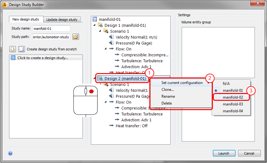

Associate Designs
-  Right click on a design.
- Select Set current configuration.
- Select the CAD design from the list.

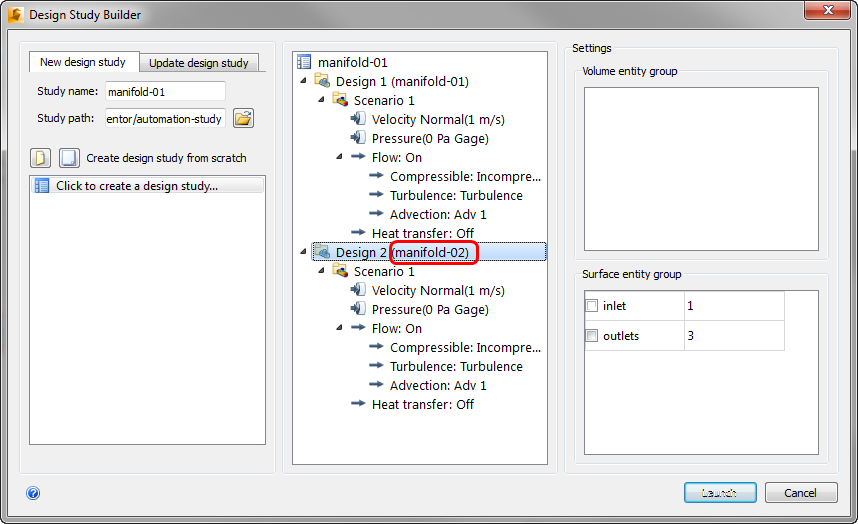

The CAD design name appears beside the design name in the tree:
