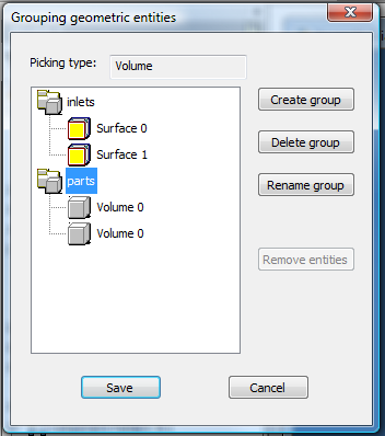

To create a CAD Entity group
- In CAD, click the icon or command to open the Autodesk Simulation CFD grouping dialog.
- Click Create group.
- Set the Picking type to either Volumes or Surfaces.
- Enter a group name. (Use something descriptive as this name appears in Autodesk Simulation CFD.)
- Highlight the group name, and select entities.
Note: Create a CAD Entity group for each distinct boundary condition and material.
