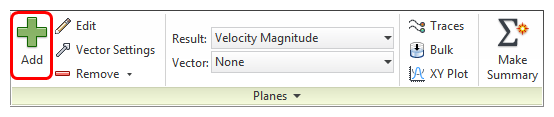

To create a Plane
-  On-model: Right click on or near the model (not on an existing Plane). Click Add plane.
-  Off-model: Click Add in the Planes context panel:
