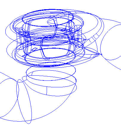

The Diagnostics function searches for surfaces that are extremely thin and edges that are extremely small relative to the rest of the model. In many cases, these entities are caused by poor geometry creation practices, a lack of design intent, or are the result of multiple format conversions throughout the life of the design model.

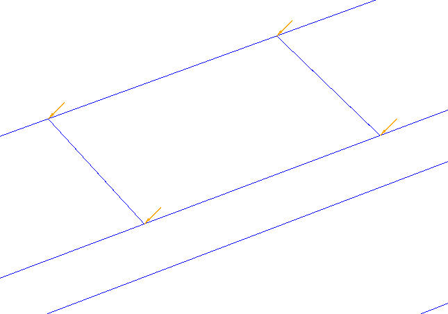

As an example, the model shown has four very small edges at the corners of the cut-out. Each edge is highlighted, and is identified with an arrow:
This improves the mesh on very small features, but may increase the number of nodes and elements in your analysis model. This is necessary if important edges fall below the default Minimum Refinement Length.

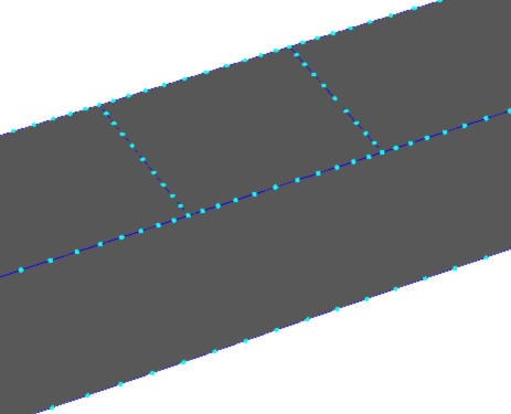

In the following image, the Minimum Refinement Length is set to be smaller than the length of the four small edges. Note their effect on the mesh:
Edges that are longer than the default Minimum Refinement Length are meshed finer, and affect neighboring geometry.
Edges that are shorter than the default Minimum Refinement Length are meshed coarsely, and do not affect neighboring geometry.

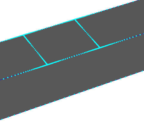

In the image below, the Minimum Refinement Length is set to be larger than the small edges. The mesh distribution will be considerably more coarse. The edges will be meshed, but will not strongly affect the mesh on surrounding geometry:
Changes to the Minimum Refinement Length affect the model globally, and are not isolated to a particular location. Care must be taken so that the Minimum Refinement Length is not accidently made larger than other important edges elsewhere in the model. Doing so will effectively remove their influence on the mesh, and may lead to accuracy issues.

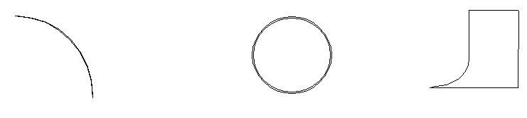

Surface mode Diagnostics identifies potentially problematic surfaces that may lead to meshing difficulties. Examples of such surfaces include slivers (left), very thin annular surfaces (middle), and surfaces with a “cusp” or tangency region (right):
Surfaces are deemed “problematic” based on the separation distance between edges. The variation of separation distances is assessed to determine a minimum threshold. All surfaces with an edge separation distance below this threshold are considered potentially problematic, and are shaded.
Extremely high-aspect ratio surfaces such as slivers and annuli have edges that are very close to each other within the separation distance. Surfaces that contain tangencies may be mostly well formed, but can be considered problematic because of the tangency between two or more edges.

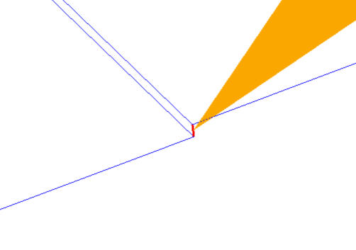

Identification
The first function, identification, is performed by coloring the surfaces orange. Use the slider on the dialog to vary the edge separation distance from the threshold to the minimum.
When the slider is moved to the left, the display is restricted to progressively smaller surfaces until the far left position--which shows the very smallest surface or surfaces. Displayed problematic surfaces can then be added to a group and saved to an external text file for reference.
The text file makes it convenient to locate the surfaces in the CAD model and apply a fix.
