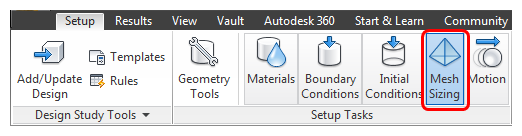

To access the meshing tools, click Setup (tab) > Setup Tasks (panel) > Mesh Sizing:
You can use these tools to help you define, modify, and preview the mesh.

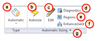

To Apply Automatic Mesh Sizing
There are several ways to apply Automatic Sizing:

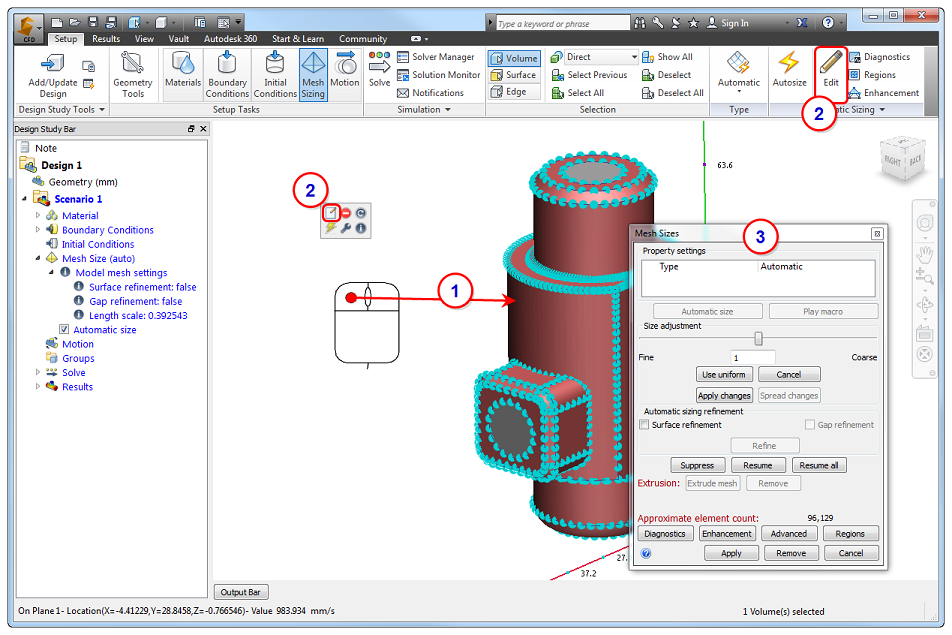

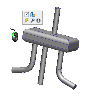

Use the Mesh Tools to customize the mesh distribution. All tools are accessible from the Mesh Sizes quick edit dialog. To simplify the workflow, many are also available on the context tool bar and on the context panel.
Context tool bar
Left click on or near the model:
Context panel in the Ribbon
To modify the mesh directly on the model
