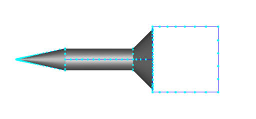

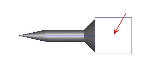

An example is a volume constructed in the wake of an aerodynamics study. The volume is simple, so its automatically-defined mesh will be coarse. Because the flow is quite energetic and will have high gradients, a finer mesh is required in the wake region:
A mechanism is provided that allows for the local adjustment of automatically assigned mesh sizes on volumes, surfaces, and edges after Automatic Sizing has been invoked:
