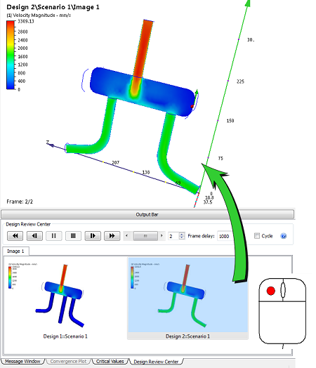

In the Design Review Center tab of the Output Bar, the image from each scenario is shown. If a scenario has not been run or needs to be updated, a place-holder image is shown instead of the actual image.
To compare the views, use the Design Review Center slider and animation controls. The Design Review Center Mode is now active.
