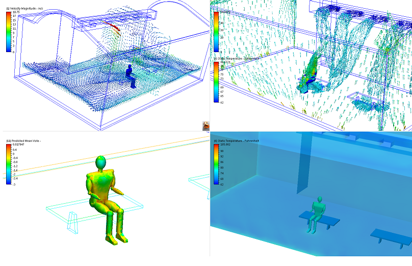

Viewports
Use Viewport to control the number and configuration of individual model views:

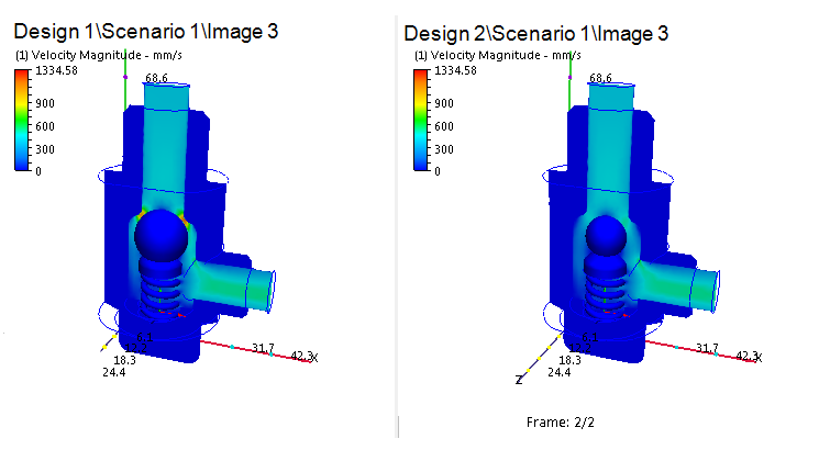

Multiple viewports are useful for assessing results from individual scenarios as well as multi-scenario design studies:
Single Scenario
Multiple Scenarios

By default, the view or model in each viewport is navigated individually. To navigate all viewports together, click Link Views.
This is useful for assessing the influence of two or more results quantities at a specific location. For example, velocity and temperature are often closely related in electronic devices. A higher than expected component temperature is often due to a lack of air flow around the component. Linked viewports showing temperature and velocity helps this effect to be identified at a specific location. For multiple scenarios, linked views provide a clear way to compare results from across several design iterations.
