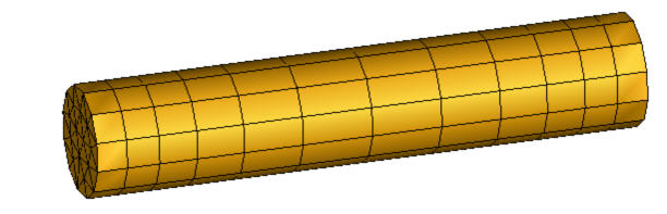

Extrusion meshing stretches triangular faces into multiple layers of wedge (prism) elements through the length of three dimensional parts with a uniform cross section. Extrusion meshing greatly reduces the element count in high aspect-ratio parts, and improves flow accuracy in models dominated by skin friction drag, such as pipe flow.
Extruded meshes are structured meshes, but can contact or even be immersed in regions meshed with unstructured tetrahedrals. This is called “non-conformal” meshing, and is a condition in which the nodes in the extruded section do not line up automatically with the surrounding mesh. Autodesk Simulation CFD detects and deals with this situation automatically.

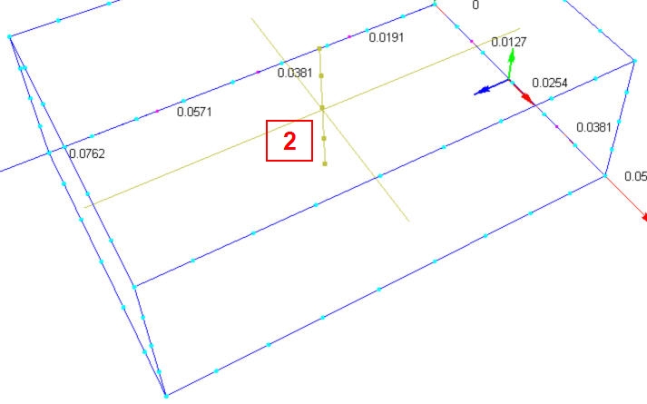

Extrusion Preview
A Preview Line is drawn through the part to indicate the layers. This is interactive, and updates as settings in the Extrusion dialog are adjusted. While this dialog is open, surfaces will blank on the active parts by right clicking on them to allow visibility of the preview. The Preview line below shows the extrusion for a Growth setting of 1:
