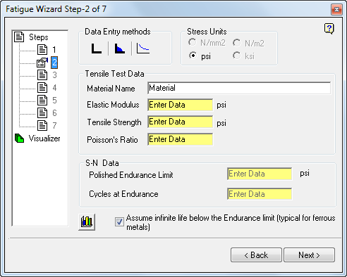

In Step 2 of Fatigue Wizard, enter the material properties to use in the fatigue analysis. The form presented depends on the type of fatigue analysis you chose in Step 1.
For example, different material data is required for the definition of a strain-based analysis than a stress-based analysis. The Fatigue Wizard tailors the form presented at Step 2 to highlight only the data that is required for the chosen analysis type.
However, some inputs to this step are common to all analysis types.
Stress Units
The units system is picked up automatically from the Simulation Mechanical stress files. Therefore, the appropriate stress units are preselected, and all other units are unavailable for selection (grayed out). The Model Units in your Simulation Mechanical analysis must be consistent with those available within Fatigue Wizard in order to perform a valid fatigue analysis. For example, you must avoid using dynes and microns (µ).

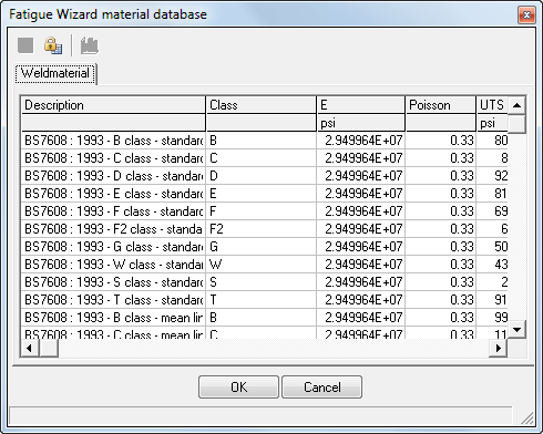

You can also select Weld material data (Stress based method only).
The weld material database is shown in the following image:
The weld SN curves are mainly taken from BS 7608 : 1993 Code of Practice for Fatigue design and assessment of steel structures.

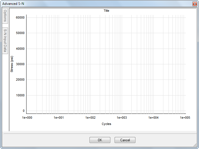

User-Defined S-N data input (Stress based method only):
Before selecting this third input option, you must first specify a nonzero Tensile Strength for the material. Then, click the User-Defined S-N data icon. The following dialog box appears:
The two tabs along the upper-left edge are used to access pull-out dialog extensions.
Use the Options tab to set whether the X and Y scales are linear or logarithmic.
In addition, you can choose to include a grid, mark all data points, or mark the tensile strength or endurance limit data points. Finally, you can specify a title for the SN curve within this tab.

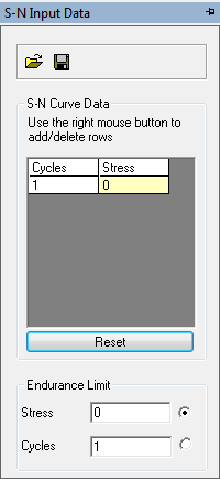

Use the S-N Input Data tab to enter the Cycles versus Stress data points into a table.
Right-click in the table to insert a row, delete a row, or reset (clear) the table. You can also import the table from a *.CSV file (comma-separated values), or export the table to a *.CSV file. There are two fields below the table that you use to define the endurance limit—Stress and Cycles. Input one value, and the other is calculated by the program. The radio button to the right of each field specifies which quantity is to be calculated. If you specify a number of cycles or a stress value that lies between two rows of the table, the program will interpolate between the data points. The program will not extrapolate for values outside of the range of cycles and stresses entered into the table.
If you elect to perform a stress-based life calculation in Step 1, you are required to enter two further inputs for the SN material data in addition to the Elastic Modulus, Tensile Strength, and Poisson's Ratio:
For more information on these material properties, see "Theoretical Overview: Stress Based Fatigue Analysis".
Select the "My material is a Steel" check box to alter the way in which the SN curve for the material is defined beyond the endurance limit. When selected, the SN curve follows a horizontal line beyond the defined endurance limit. That is, below the endurance limit of the material, there is no damage. Therefore, the material exhibits infinite life.
Assume infinite life below the Endurance limit (typical for ferrous metals): Check this box if your material is a steel or similar ferrous metal. For such metals, the fatigue life is typically assumed to be infinite at stresses below the endurance limit (no damage). If you do not activate this checkbox, the SN curve is modified at stresses below the endurance limit to give a different slope. The slope used, below the endurance limit, is proportional to (2k-1) where k is the slope of the main SN curve. Therefore, fatigue damage can still occur beyond the endurance limit, but to a lesser degree.

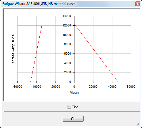

Goodman Diagram option
If you select the Goodman Diagram option, Fatigue Wizard sets up with a traditional Goodman diagram for its calculation of fatigue safety factor (FSF). The following is an example of a Goodman diagram.
The Goodman diagram uses the same value for strength in both tension and compression. This factor is a severe limitation for materials such as cast iron, which is much stronger in compression than in tension.

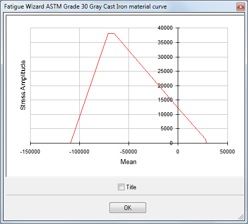

Haigh Diagram option
If you require more control over the shape of the infinite life curve, select the Haigh Diagram option. Although this method does not provide complete control over the definition of the shape of the curve, it is more versatile than the Goodman approach. This versatility is important for materials such as cast irons, which show different monotonic properties in tension and compression. Using the Haigh Diagram method, it is possible to define separate values for ultimate strength and yield strength in both tension and compression.
When you select the Haigh Diagram radio button, a separate form opens, where you can input the additional data. On this additional form, the boxes for Tensile Strength (UTS) and Fatigue Endurance Limit are automatically filled with the data from the main form of Step 2. Therefore, we recommend that you complete all data required on the main Step 2 dialog box before you access the Haigh Diagram Data entry form.
The compressive data, both Ultimate Compressive Strength and Compressive Yield Strength, are entered as magnitudes with no account of sign. Fatigue Wizard automatically assigns a negative sign to the compressive values.
If you select the Haigh Diagram option on the main form, you must enter the additional properties before you proceed to the next steps of the fatigue analysis.
The following is an example of a Haigh Diagram.
