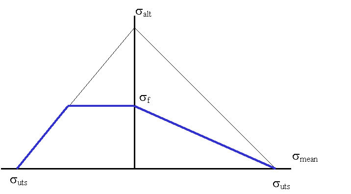

By default the FSF is calculated using the standard ‘Goodman’ diagram as shown here.
Goodman Diagram

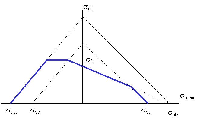

Generic ‘Haigh’ Diagram
The generic ‘Haigh’ diagram is constructed with six points. The points are calculated from input of the material UTS (tensile and compressive), material yield (tensile and compressive), and the material fatigue endurance limit. The key points in the ‘Haigh’ diagram are then defined as shown in the previous diagram.

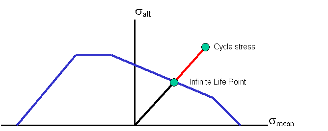

Method of Constant Stress Ratio (constR)
The basis of the method of constant stress ratio calculation is the assumption that when scaling stresses in the cycle to the ‘infinite life’ line, both the mean and alternating stresses are scaled with the same ratio.

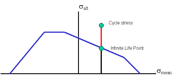

Method of Constant Mean (constM)
The basis for the method of constant mean calculation of the FSF is the assumption that when scaling stresses in the cycle to the ‘infinite life’ line, only the alternating stresses are scaled.
