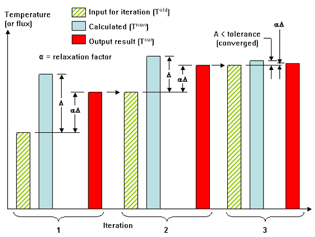

The temperature of a node after an iteration, Tnew, could be higher or lower than the final converged value. Thus, you may not want to use this value as the input for the next iteration. The value in the Relaxation parameter field can be used to minimize these oscillations. The relaxation parameter is used as follows:
Tcur = Told + (relaxation parameter)*(Tnew - Told)
In a graphical format, the relationship between the different results can be shown as Figure 1. Tcur, and therefore the effect of the relaxation parameter, is the value output to the results file.
Figure 1: Graphical Interpretation of Relaxation Parameter
A relaxation parameter between 0.8 and 1 will provide good convergence when the nonlinear effects are small. When large nonlinear effects are present such as radiation at high temperatures the relaxation parameter may need to be on the order of 0.1 to 0.3 to smooth the oscillations. The convergence history can be checked in the log file.
