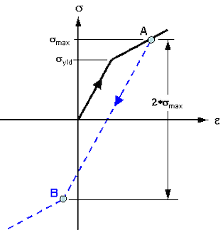

Uniaxial stress-strain curve. If the part is taken beyond the yield stress, it begins to deform plastically. If taken to a maximum stress (point A) and the load is released, it unloads along the dashed line. If the part is loaded again, no additional plastic deformation occurs until the stress reaches point A.
If the part is put into compression, it compresses elastically along the dashed line until it reaches point B, and then it yields in compression.
With isotropic hardening, the change in stress from point A to point B is twice the maximum stress obtained.

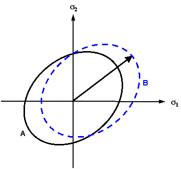

Biaxial stress-strain curve. In the biaxial case, any combination of stress inside the initial yield surface (surface A) is in the elastic region. Once the part is taken beyond the initial yield surface, the part experiences plastic deformation.
With isotropic hardening, the center of the yield surface remains fixed but the size of the surface increases. Any stress state inside the new yield surface (surface B) will experience elastic deformation; new plastic deformation occurs when the stress state reaches surface B.
  Figure 1: Isotropic Hardening

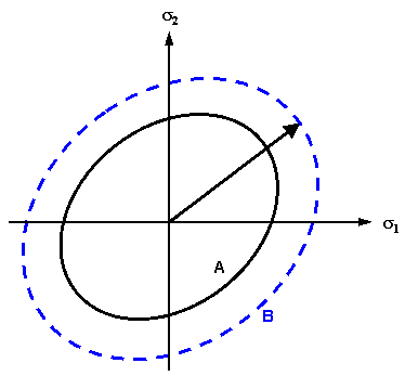

With kinematic hardening, the center of the yield surface moves but the size of the surface remains constant. Any stress state inside the new yield surface (surface B) will experience elastic deformation; new plastic deformation occurs when the stress state reaches surface B.
Figure 2: Kinematic Hardening

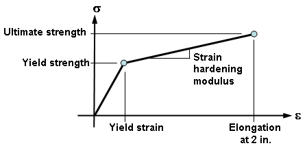

Strain Hardening Modulus
The strain hardening modulus is the slope of the stress versus strain curve after the point of yield of a material.
When the material properties for a part are loaded from a material library, the strain hardening modulus is based on the three points that define the bilinear stress-strain curve; namely, (0,0), the yield point, and a third point identified in the library manager as the ultimate strength and elongation at 2 in. The strain hardening modulus is then calculated as follows:
strain hardening modulus = [Ultimate Strength - Yield Strength]/[(Elongation at 2 in)/100 - yield strain]
where yield strain is the strain corresponding to the yield strength, or yield strain = (Yield Strength) / (Modulus of Elasticity). The Ultimate Strength, Yield Strength, Elongation at 2 in, and Modulus of Elasticity are stored in the material library.
