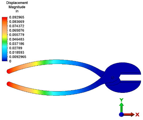

Analyze the Model
Click
Analysis
Analysis
Run Simulation
After solid meshing, the analysis proceeds and the model displays in the Results environment, as shown below. By default, the displacement magnitude is presented initially.
