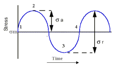

Definition of Loading
Fatigue damage is caused by loading a structure with repeating loads over a period of time. To analyze fatigue failure it is necessary to define the applied load. in the Fatigue Wizard, you can define two basic loading types, the simplest form being the constant amplitude harmonic.
This loading is fully described by the definition of a stress amplitude sa and a mean stress sm. The repeating cycle is a single harmonic period, that is points 1-2-3-4 in Figure 1.
Figure 1 Constant Amplitude Harmonic Loading

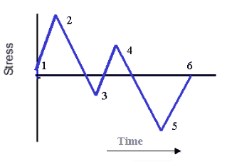

The second type of loading, and a more general case, is the variable amplitude load.
Figure 2 Variable Amplitude Loading
Variable amplitude loading is made up of many individual constant amplitude cycles. These individual cycles can each have different amplitude and mean and can be superimposed or subsequent. Figure 2 shows a simple example of a variable amplitude load. You can see that there are two simple cycles: 1-2-5-6 forms a large amplitude single cycle onto which the smaller cycle 3-4-3 is superimposed. A variable amplitude loading can therefore be broken down into a number of simpler constant amplitude loads. Then they are used in the fatigue analysis to predict damage.
If a variable amplitude load is to be used for fatigue calculation, a method must be applied to extract the ‘sub-cycles’. Fatigue Wizard applies it by a standard rainflow counting algorithm.

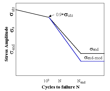

Stress Life Technique
The stress life technique utilizes a single cycle damage curve known as the SN curve. This curve relates stress amplitude to number of cycles to failure. Since this technique has been used widely for many years, such curves and material data relating to such curves are readily available. The stress value used with the curve depends on the data represented in the curve, and to an extent, the discretion of the engineer. The uniaxial version of Fatigue Wizard uses the ‘worst absolute principal’ stress in its calculations, since the direction of the stresses is assumed constant.
Fatigue Wizard generates the SN curve internally from the material data input by the engineer. Data required are the monotonic tensile strength of the material, and an ‘endurance limit’.
Figure 3 SN Curve
The SN curve takes the form shown in Figure 3. SN curves are always plotted on log-log scales, as shown. The curve starts from the monotonic tensile strength suts at log(N)=1. It is then common to approximate the range up to a value of 1000 cycles by a straight line to a value of 90% of suts. The main slope of the SN curve extends from the 1000 cycle point to a life value corresponding to the ‘endurance limit’ and a stress amplitude equivalent to send. The behavior beyond the endurance limit then depends on whether the material is a ferrous alloy or non-ferrous alloy. It is typical for steels to show a real endurance limit and a flattening of the SN curve. Conversely, aluminium alloys and other non-ferrous alloys show a less distinct flattening of the SN curve at high cycles. Fatigue Wizard allows the user to distinguish between these two cases.

Endurance Limit Modifiers
SN curve data is usually presented from tests on standard sized polished specimens. Applying this ‘laboratory’ test data to real engineering components sometimes requires some correction. The corrections usually take the form of ‘modifiers’ applied to the specimen endurance limit.
Modifiers can be applied to take account of size, surface finish, stress gradients, surface treatments, ‘loading type, and so on. These modifiers are well documented in many engineering texts and readily available to the engineer if required.
send-modified = send . nsize . nsurface …
where n is the appropriate modifier
Fatigue Wizard supplies standard modifiers for surface finish effects and statistical effects and a general modifier to input a calculated combined value. Fatigue Wizard modifies the SN curve by scaling the specimen endurance limit as above, and rotating the SN curve about the 1000 cycle point.

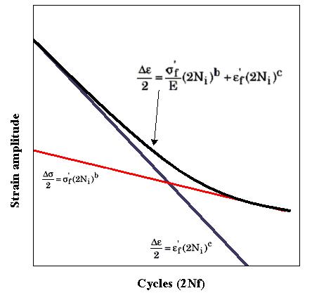

Strain Life Technique
The strain-life technique was developed in the 1960’s as an improvement to the stress-life technique for predicting fatigue failure in material, which undergoes plastic deformation. The principle is the same, in that strain amplitude (rather than stress) is measured or calculated, for a cyclic load, and compared to an empirical graph of strain amplitude against life. The advantage over the stress-life approach is that there is no inherent assumption in the test data regarding totally elastic deformation.
Strain-Life Curves
Strain-life curves describe the fatigue behavior of laboratory tested specimens. Specimens are usually tested under fully reversed strain controlled load and correlated against life to crack initiation. An empirical curve of strain amplitude against cycles to failure is plotted.
For low levels of strain where deformation is completely elastic, the fatigue behavior correlates to the stress amplitude and
Where sf’ is the fatigue strength coefficient and b is the fatigue strength exponent, both extracted from the log-log fit of stress amplitude against life.
For high levels of strain where deformation is predominantly plastic the fatigue behavior correlates best with strain amplitude such that
Where ef’ is the fatigue ductility coefficient and c is the fatigue ductility exponent, both extracted from the log-log fit of plastic strain amplitude against life.
The general strain life curve or Coffin-Manson curve is then described as a combination of these two individual straight line curves, such that
Figure 5 Constant Amplitude Strain Life Curve. Coffin-Manson relationship.

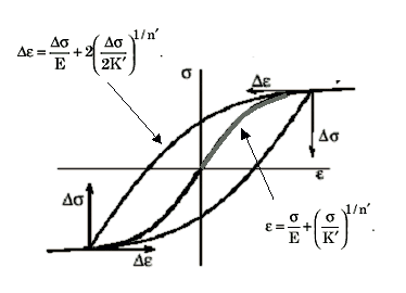

Elastic-Plastic Material Data
Since strain-life data is extracted from materials, which are subjected to cyclic loading beyond the elastic limits, it is necessary to define a cyclic stress-strain material curve.
Fatigue Wizard utilizes two well-documented empirical formulae for the definition of cyclically stable stress-strain curve.
The cyclic stress-strain curve is constructed by using the Ramberg-Osgood relation to determine material constants K’ and n’. That is, the cyclic hardening coefficient and the cyclic hardening exponent.
Ramberg-Osgood relationship
To generate a complete cyclic stress-strain curve, Masing’s Theory is used such that:
By combination of these two relationships a full hysteresis loop of the cyclically stable stress-strain curve can be generated from the two material constants.
