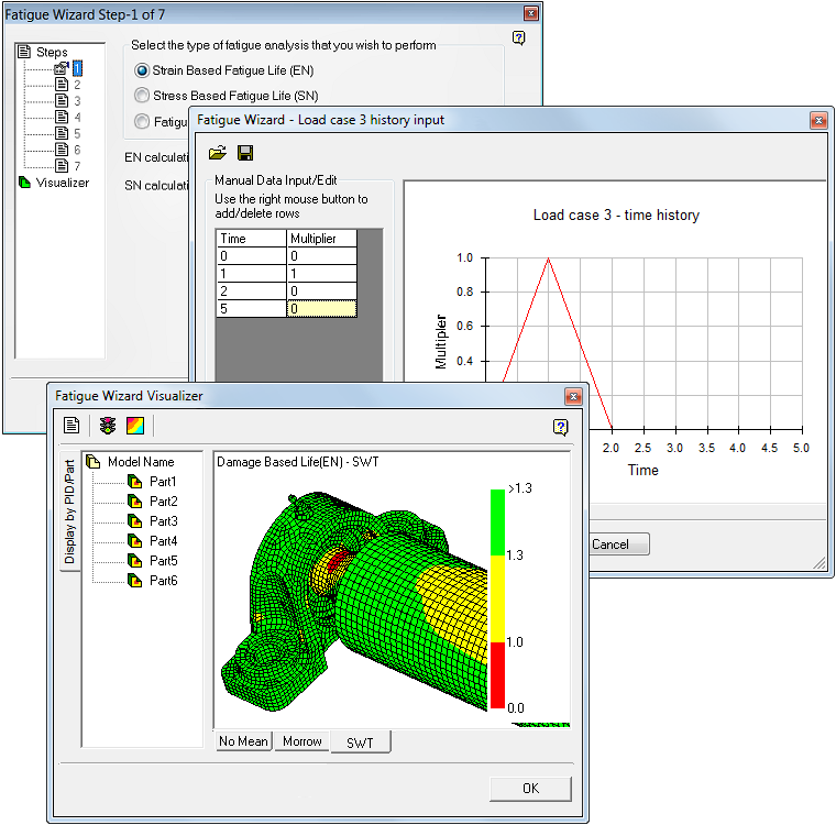

The Fatigue Wizard software enables CAE engineers of any experience level to utilize results of a finite element analysis to carry out sophisticated and accurate fatigue life calculation. CAE engineers with over 30 years combined experience and knowledge of finite element analysis and durability assessment developed it.
The Fatigue Wizard leads you through the steps necessary to perform complex fatigue life calculation. You can view results as life or safety factors using the Fatigue Wizard post processor, or export and view in Autodesk® Simulation Mechanical. With minimum effort and time, you can use Fatigue Wizard to generate customizable reports.
Launch Fatigue Wizard from the Fatigue Analysis command that appears in the Simulation Mechanical ribbon. The command is located within the Analysis panel of the Analysis tab and appears in both the FEA Editor and the Results environments.

Fatigue Wizard can perform sophisticated fatigue life analyses, from conventional stress-based (SN) analyses to low cycle strain-based (EN) analyses with plasticity correction. Mean stress corrections can be accounted for using standard methods. Endurance modifiers such as surface finish, temperature, and so on, are all available. For a complete list of the capabilities within the Fatigue Wizard, follow the features link.

Fatigue Wizard can perform fatigue calculations using stress results from multiple load cases. Results from multiple load cases can be scaled individually using separate load histories of up to 30000 points, and analyzed as a combined load case. Alternatively, stress states from individual load cases can be used in sequence to produce the cyclic stress history.

Fatigue Wizard includes post processing tools. An OpenGL results post processor is included within the wizard interface. You can view life contours or safety factor contours before you step back to perform 'what-if' analyses.
