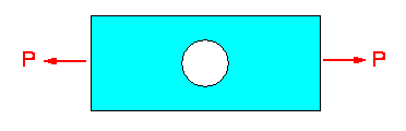

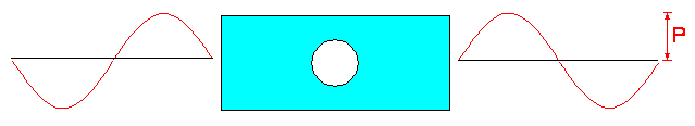

You performed a Linear Static Analysis using the loading shown in the following image, and reviewed your stresses.
The load P is a static constant load.

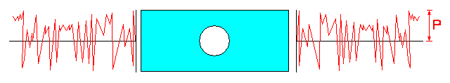

But, in reality this load can be applied and then removed many times, as in the following image. If necessary, evaluate the fatigue performance of your model under this cyclic event.
For example:
Or

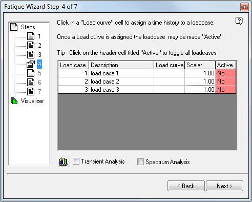

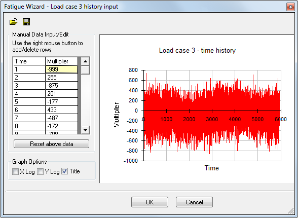

The following steps describe how to apply a load history to the static event. Click the "Load curve" field for the required load case from your Linear Static Analysis. For example, to define a load curve for Load case 3, click in the third row of the "Load curve" column.
This form displays, where you can input load curve data by various means.

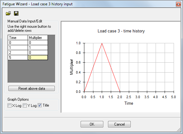

Method 1 is to enter load curve data into the form directly. To add or delete rows from the Time vs. Multiplier table, right-click and choose the desired command.
The second input method is to import a *.CSV file (comma-separated values). Several curves are included with the program installation. These curves (*.CSV files) are located within the \Addins\Fatigue Wizard subfolder of the Simulation Mechanical installation folder (typically C:\Program Files\Autodesk\Simulation 20xx ).
The following example illustrates an imported CSV file ("SAE test data bracket.csv" from the ...\Addins\Fatigue Wizard folder):

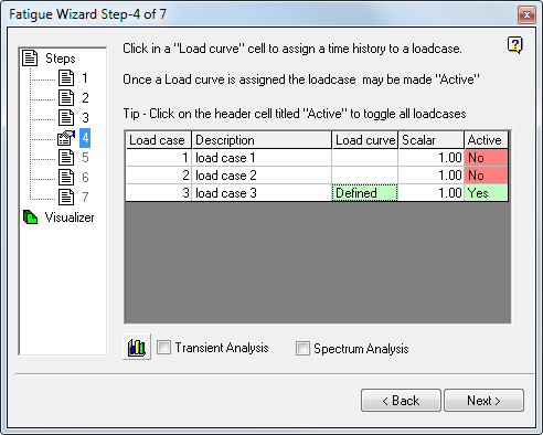

When the load curve data is entered or imported into the form and accepted, you are returned to the main 'Step 4' form. The form is updated to indicate that load curve data has been entered and assigned to a load case. In this case, the load curve for Load case 3 is "Defined" and "Active."
If necessary, after the load curve data is defined for a load case, you can remove it from the fatigue calculation by 'de-activating' the load case. Click the "Active" cell to toggle its status.

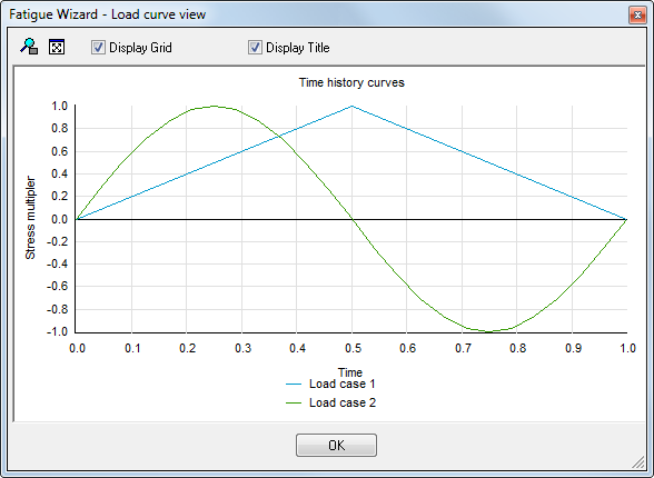

To view all load cases on a single graph, press the "View all load curves" button (
). In the view that displays, ensure that all curves start and end at the same times.

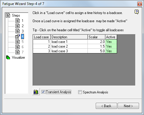

To enter transient information, select the load cases to define your cycle, enter a stress scale factor (if necessary), and activate the Transient Analysis checkbox. The Load curve column is hidden while in Transient Analysis mode.
The order of the stress states in the cycle is determined by the order in which they appear in the FE model. Therefore, if using the transient method, set up the FE model correctly for the anticipated fatigue analysis cycle.
