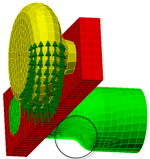

Often, critical stresses are limited to one or two small areas of a model. When Global Mesh Refinement is used, the resulting mesh is often finer than necessary because all elements are resized. A more efficient approach is to refine the mesh locally, only where the critical stress regions are. The Local Mesh Refinement command provides a semi-automatic means of performing this targeted mesh refinement on CAD-based models.
Before performing local mesh refinement, first perform the following steps:
Mesh Refinement
Local Mesh Refinement.
Figure 1: Local Mesh Refinement Region
New design scenarios are created for each refinement iteration, and the original and refined design scenarios are solved. You will see the effects of the local mesh size reductions for each design scenario as they are being prepared. The following image shows the local mesh refinement for the last iteration of our example model:
Figure 2: Refined Mesh in Local Mesh Refinement Region
