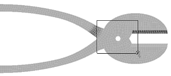

Navigate
Zoom
Window. Draw a rectangle around the hole as shown in the following image to zoom into the fulcrum area. You can also access the
Zoom Window command from the zoom fly-out menu on the Navigation Bar, if preferred.

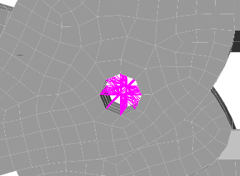

Joint and click OK to create the joint. The default type is "Pin Joint (lines to axis endpoints)." Lines from each vertex on the selected surfaces will converge at two endpoints along the centerline of the selected holes. Alternatively, a "Universal Joint (lines to axis midpoint)" can be created where appropriate (for example, to model a ball-joint connection). A universal joint is not appropriate for this model.
- Click the heading for Part 3 in the browser to select the joint and make it more visible.
- Click the middle mouse button and drag to slightly rotate the model and inspect the joint. It appears as shown below:
- Click the Top face of the ViewCube. The model appears as shown in the following image.
Note: Since trusses are used by default when creating joints, the parts will be free to rotate relative to each other, about the axis of the pin joint. Trusses only support axial loads and act as if each end were a frictionless ball-joint. If a torsionally rigid joint is needed, the element type can be changed to beams.
