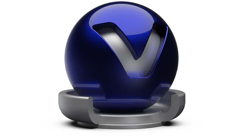

Metallic Carpaint
A metallic car paint material has extra small particles made of metal, or flakes, on top of its lacquer layer. These particles increase the brightness within the angle of incidence, causing a light textured look. The color and size of the flakes is customizable.
Metallic Carpaint Material
