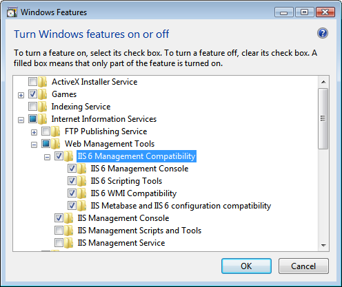

Windows Server 2008 and Windows 7
Check the IIS 6 Management Compatibility is installed.
- From the Windows control panel double click Programs and Features
- On the left side of the dialog box select Turn Windows features on or off.
- Expand the Internet Information Services option.
- Expand the IIS6 Management Compatibility option and check all the sub options.
