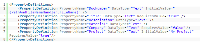

In this sample, the path generated by Data Standard is the workspace folder set in the application plus the project name selected or entered into the Data Standard dialog. As the workspace will not change, this part is fixed, while the project path changes depending on the user data. All the fields that will be accessible in the Data Standard dialog as a property must be defined here. The name of the property is also the name of the file or title-block property. If the property name matches an existing file property, such as title, then this file property is used. Otherwise a custom property is created. The only exception to this rule is AutoCAD. When AutoCAD synchronizes properties, it does so from Data Standard to the title-block attributes, not to the file attributes.
Property |
Required |
Description |
Supported Values |
PropertyName |
Yes |
the name of the property |
characters and numbers |
DataType |
Yes |
defines the data type |
text, date, number, double, boolean |
InitialValue |
No |
defines which value should be filled the first time |
any text |
RequiresValue |
No |
defines whether the field must contain a value or not |
true, false |
Regex |
No |
defines a regular expression for controlling user entry |
regex syntax |
SyncDWGProperty |
No |
defines whether DWG properties are synced/created with the value entered in the Data Standard dialog. See Map AutoCAD DWG Properties in Data Standard with the SyncDWGProperty Attribute for more information. |
true, false |
