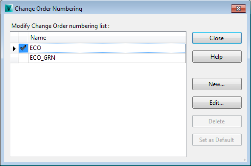

  3. In the Change Order Numbering section, Click Define.
    The Change Order Numbering dialog opens.
  4. In the Change Order Numbering dialog box, click New.
