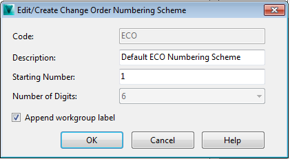

Numbering Schemes let you configure how change orders are named when they are added to the vault. You can indicate the starting change order number and control how many digits are displayed.
If using workgroups, the workgroup label can be appended automatically to the Change Order name.
