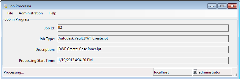

The Job Processor is a separate application that reserves queued jobs and pulls them from the job server to process them. Since the job processor is installed along with the Vault client, any workstation with the appropriate edition of Vault can be used to process jobs.
From the Job Processor dialog a user can pause and resume processing, set the Vault user account that is used to process jobs, and view the types of jobs that the Job Processor is configured to process.
| Detail | Description |
Job ID |
Displays the number of the job currently being processed. |
Job Type |
Displays a description of the job being processed. |
Description |
Displays more information about the job in the queue. |
Status |
Displays the current state of the Job Processor. |
Status Bar |
Displays the server name and the user account. |
Processing Start Time |
Time at which the Job Processor began working on a job. |
