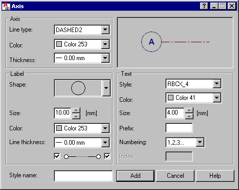

Use this dialog to define or modify an axis style.
To display the Axis dialog:
- On the Styles of symbols dialog, for Symbol, select Axis
- Click New or Modify.
Specify axis parameters:
- Under Axis, define line type, color, and thickness parameters for the axis line
- Under Label, define shape (circle, ellipse, square, octagon), size, color, and thickness parameters for the axis label. Also, you can specify which ends of the axis should display the label
- Under Text, define the style, color, and size of the label text. Also, you can specify a prefix and a numbering type (A, B, C; 1, 2, 3; I, II, III; or user-defined)
- For Style name, enter a name for the axis style, and click Add.
