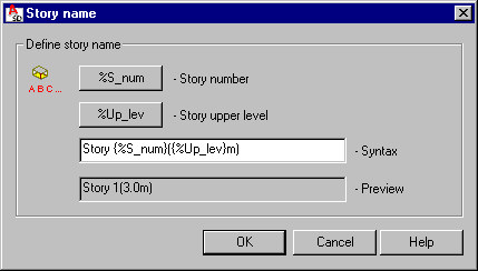

In the Story name dialog, you define a syntax of names assigned to stories in a building. To open the dialog, click the Browse (...) button in the Building parameters dialog.
Use the variables in the dialog:
As you click to select a variable, it is added to the syntax of the story name and a Preview displays the result.
A story name defined using the above syntax is taken into account only when you define a new story or copy an existing one.
