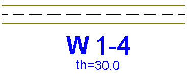

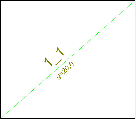

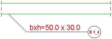

Example of descriptions are illustrated in the drawings below. Take note that a position name has other text parameters (larger font) than the description text:
