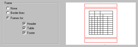

After you select Frames from the selection tree in the left part of the Table printout manager dialog, the options shown below display on the right.
Determine the manner of table framing:
- None - no separation between a header/footer and table
- Border lines - includes lines that separate header and footer from the table
- Frames for - select to include frames for the header, the table, the footer, or any combination of the three
