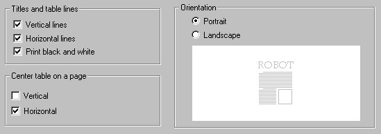

After you select Page setup from the selection tree in the left part of the Table printout manager dialog, the options shown below display on the right.
Determine the manner of table presentation:
- Under Titles and table lines:
- Vertical lines - if this is not selected, no vertical lines are displayed in a table
- Horizontal lines - if this is not selected, no horizontal lines are displayed in a table
- Print black and white - if this is not selected, a table is printed with the defined colors applied
- Under Center table on a page, specify how a table is to be centered (horizontally, vertically, or both)
- Under Orientation, define paper orientation (Portrait - the longer side of a paper sheet is vertical or Landscape - the longer side of a paper sheet is horizontal)
