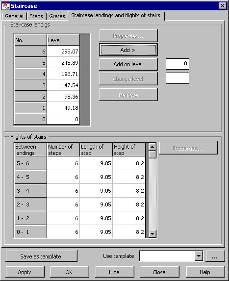

Use the options provided on the Staircase landings and flights of stairs tab to define parameters of landings and flights of stairs.
Work with staircase landings:
To modify landing properties, select a landing from the list and click Properties.The Staircase landing properties dialog displays, where you can modify properties.
Under Flights of stairs is a list of flights that are added to the list automatically after adding landings.
To modify properties for a flight of stairs, select it on the list and click Properties. The Flight of stairs properties dialog displays, where you can modify properties.
At the bottom of the dialog is the Use template selection field, which contains user-defined templates (schemes) of staircases. After you define staircase geometry, you can save the settings by typing a name in the Use template field and clicking Save as template. In the future, after you begin to define a staircase, you can select the name of a saved template so that all its parameters will be applied to the new staircase.
Use the buttons at the bottom of the dialog:
