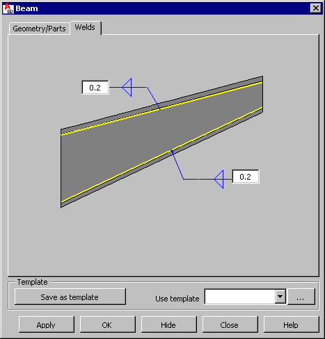

After you have defined the plate girder dimensions, use the Welds tab to define weld thicknesses.
Define two-sided welds:
At the bottom of the dialog is the Use template selection field, which contains user-defined templates (schemes) of plate girders (beams). After you define plate girder geometry, you can save the settings by typing a name in the Use template field and clicking Save as template. In the future, after you begin to define a plate girder (beam), you can select the name of a saved template so that all its parameters will be applied to the new plate girder.
Use the buttons at the bottom of the dialog:
