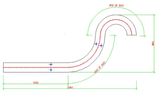

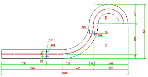

- When Orthogonal is selected, curved parts display as standard objects so that their actual shape is shown and dimensions are generated in the orthogonal system (compare example dimensions generated with the use of this option in the drawing below).
- When Aligned to curve is selected, curved parts display as curved objects so that their actual shape is shown and dimensions are generated in the system adjusted to the profile curvature (compare example dimensions generated with the use of this option in the drawing below). Total dimensions are displayed in the orthogonal system (coordinate system of the curved part), and the remaining dimensions are generated in the longitudinal / transversal system. Longitudinal dimensions are always parallel to the profile axis (dimension values are calculated along the length of arc axis, and a radius value is given in parentheses); transverse dimensions are segments perpendicular to the profile axis and passing through the dimension point.

- When Orthogonal is selected, assemblies display as standard elements so that their actual shape is shown and dimensions are generated in the orthogonal system.
- When Aligned to curve is selected, assemblies are displayed as curved elements so that their actual shape is shown and dimensions are generated in the system adjusted to the profile curvature. Total dimensions are displayed in the orthogonal system (coordinate system of the curved part), and the remaining dimensions are generated in the longitudinal / transversal system. Longitudinal dimensions are always parallel to the main part axis (dimension values are calculated along the length of arc axis, and a radius value is given in parentheses). Total transverse dimensions are determined by cutting planes (external transverse dimensions are parallel to total transverse dimensions); internal transverse dimensions are segments perpendicular to the profile axis and passing through the dimension point.
