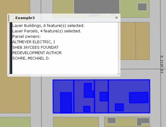

Example 3 creates a dialog that displays some details about the current selection. It updates automatically when the selection changes. It uses the following files in the folder C:\Program Files\Autodesk\Autodesk Infrastructure Web Server Extension 2015\www\fusion:

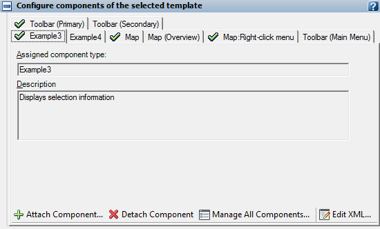

Within Infrastructure Studio, widgets that are dialogs are treated differently from widgets that are run from menus. The widget information file for Example 3, widgets\widgetinfo\example3.xml, contains the following:
<WidgetInfo> <Type>Example3</Type> <LocalizedType>Example3</LocalizedType> <Description>Displays selection information</Description> <Location></Location> <Label>Example3</Label> <Tooltip></Tooltip> <StatusText></StatusText> <ImageUrl></ImageUrl> <ImageClass></ImageClass> <StandardUi>false</StandardUi> <ContainableBy></ContainableBy> </WidgetInfo>
The <ContainableBy> element is empty because this widget is a separate dialog and cannot be added to a menu. In Infrastructure Studio, this widget does not appear in the component list for toolbars and other containers.
The template definition file, templates\mapguide\examples.xml, contains a <Panel> element that can hold dialogs or containers:
<Panel> <Name>Example3</Name> <Label>Example3</Label> <Description>The dialog displaying example 3</Description> </Panel>
By default, Infrastructure Studio places widgets with matching names into the appropriate panel. The panel name matches the <div> ID in the index.html file. If a given template uses a dialog-style widget it must have a matching <div> element. The <Panel> elements create tabs in the Infrastructure Studio UI.

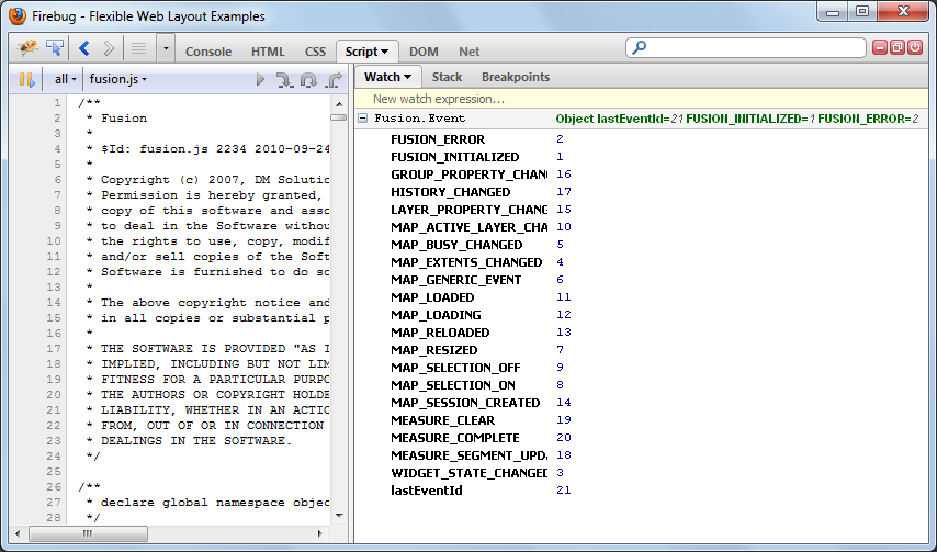

Example 3 uses the events Fusion.Event.MAP_SELECTION_ON and Fusion.Event.MAP_SELECTION_OFF, which trigger when the selection changes.
The initialization code for the Example3 widget, in Example3.js, registers event handlers for both these events, as follows:
this.getMap().registerForEvent( Fusion.Event.MAP_SELECTION_ON, OpenLayers.Function.bind(this.updateSelection, this)); this.getMap().registerForEvent( Fusion.Event.MAP_SELECTION_OFF, OpenLayers.Function.bind(this.clearSelection, this));

When the dialog is open it reacts to changes in the selection. Any time the selection changes, the dialog updates to show a list of the currently selected features.
