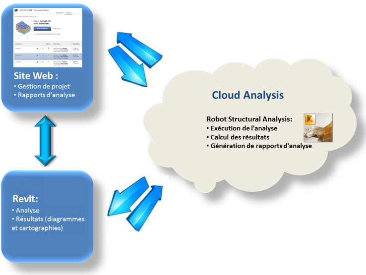

Structural Analysis for Autodesk Revit : workflow
