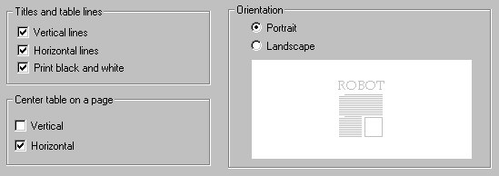

After you select Page setup from the selection tree in the left part of the Table printout manager dialog, the options shown below display on the right.
Determine the manner of table presentation:
o Vertical lines - if this is not selected, no vertical lines are displayed in a table
o Horizontal lines - if this is not selected, no horizontal lines are displayed in a table
o Print black and white - if this is not selected, a table is printed with the defined colors applied
