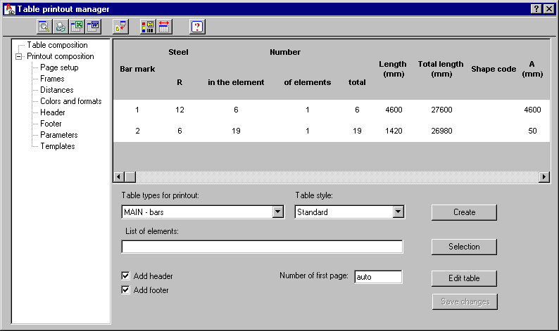

The Table printout manager dialog has 2 primary parts:
- On the left is the selection tree (see the drawing below) from which you can select one of the printout manager options
Table composition
Printout composition
Page setup
Frames
Distances
Colors and formats
Header
Footer
Parameters
Templates
- To the right of the selection tree are the parameters that relate to the option you selected in the selection tree. The top part of the dialog shows the layout of a selected table type.

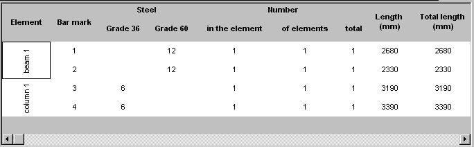

Although a table shape (cell height, column width) depends directly on a defined table style, you can determine the shape.
In addition, there is a context menu with the following options:
- Table cells - group (merges several table cells into one cell) or ungroup
- Text orientation - vertical, horizontal
- Adding or deleting a column in the table
- Adding or deleting a row in the table.
The example below shows a table layout after adding a new column at the beginning of the table, merging several table cells, and changing text orientation to vertical. The table displays data for a few positions of structure element reinforcement.
