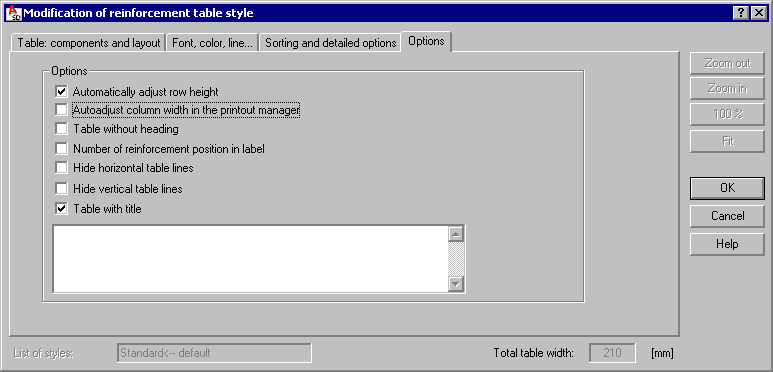

Once the Options tab is selected in the Definition/modification of reinforcement table style dialog, the following dialog displays:
The following options are available in the Options field:
symbol appears), then height of table rows will be automatically adjusted to the size of symbols of element shapes presented in the table
symbol appears), then widths of table columns are automatically adjusted to fit lengths of titles of table columns (see the description of the Table printout manager dialog)
symbol appears), then the table generated will not have a heading
symbol appears), then a number of reinforcement position in the table will be presented in a circular label
symbol appears), then horizontal lines will not be shown in the table
symbol appears), then vertical lines will not be shown in the table.
symbol appears), then the edit field in the lower part of the dialog becomes accessible and a table title may be entered; a font used in the table title is defined on the Font, color, line tab.
