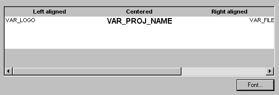

After you select Header from the selection tree in the left part of the Table printout manager dialog, the options shown below display on the right.
In order to change the layout of the printout header, select the table field you want to change, and then select a value from the list. To select a font for a particular field, position the cursor in the field, and click Font. In the dialog that opens, you can choose the font to be applied.
