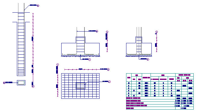

A document is a set of drawings (views) of RC structural elements; which consists of views. A document cannot be printed.
A view is a single drawing which always constitutes a document component. If a view is added to a printout, then it is simultaneously a printout element. Views (drawing) can only be printed when contained in a printout.

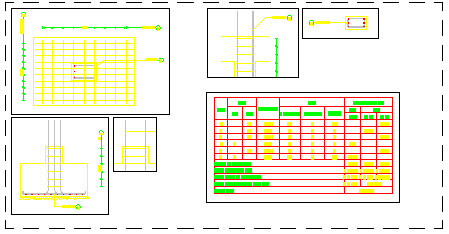

A printout is a prepared, ready-to-use document that consists of views. Each printout corresponds to a single layout.
All operations are performed in printout layouts.
A printout layout is an object of the AutoCAD® program, and is used for composition of a final printout. For each printout layout there is one printout.
