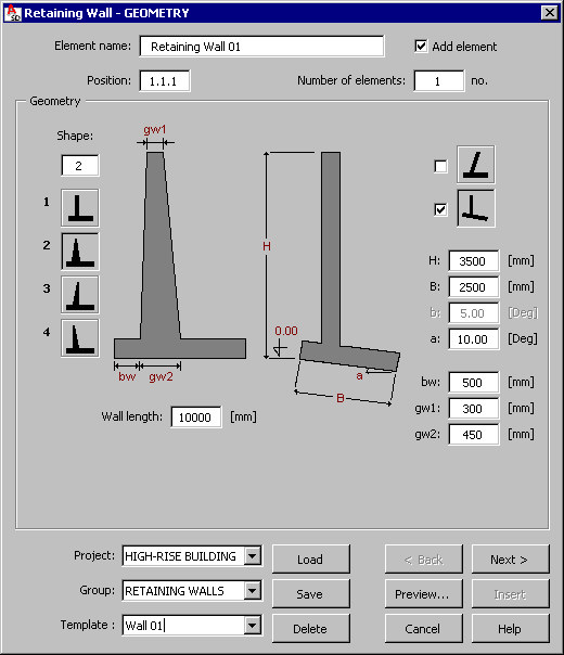

This option is used to define the geometry and reinforcement of a retaining wall. Select the option from:
The following dialog displays:
The following information displays in the dialog:

The following selections are available for retaining wall geometry:
with the front and rear wall surfaces symmetrically inclined
with the front wall surface inclined and the rear surface vertical
with the rear wall surface inclined and the front surface vertical.
The features of the retaining wall can be combined with each other, i.e. it is possible to define a retaining wall with the wall and footing inclined.
Individual dimensions of a retaining wall are defined in the edit fields located in the right part of the dialog. A number of available edit fields depends on a selected type of a retaining wall.
The lower part of the dialog holds an edit field for defining a length of a retaining wall.
After completing definition of general dimensions of a retaining wall and clicking Next, the Retaining wall - Footing dialog displays.
