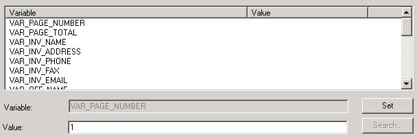

After you select Parameters from the selection tree in the left part of the Table printout manager dialog, the options shown below display on the right.
The dialog contains all the variables defined in the system and their names.
