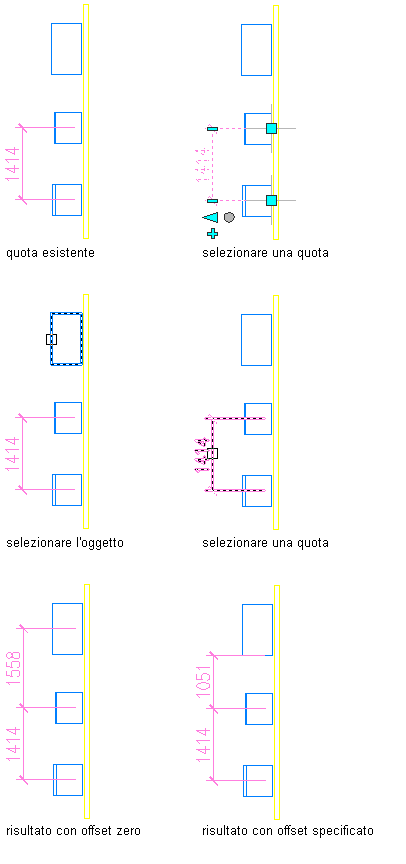

- Verify that OSNAP is turned on.
- Select the AEC dimension to which you want to add associative points, and click
Find.
- Select the AEC object OSNAP points you want to dimension.
Note: OSNAP points on AutoCAD objects will be filtered out of the dimension.
- Press Enter.
- Select the AEC dimension chain to which the points should be added.
Adding and offsetting non-style defined dimension point to an AEC dimension
