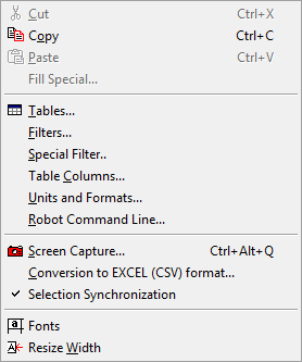

Executing these commands opens a standard table in which the initial user data or the results are displayed (such as node numbers, applied loads, and displacements). Available options for each dialog allow for content configuration. Right click to access these options (including filtering/sorting, table content management options, and others).

Tables have a default column setting (column number and width). The column length may be adjusted by moving its right margin and the column number may also be changed. Once the calculations are finished, a table containing the reaction values for structure support nodes is displayed on the screen. Additional columns containing data and the remaining calculation results can be added to the table. Right click in the table, and select the Columns to open the dialog in which the presentation values of the table may be selected. The dialog is made up of tabs such as General, Displacements, and Reactions. Select the desired parameters within the tabs and click OK to add or replace existing columns.
