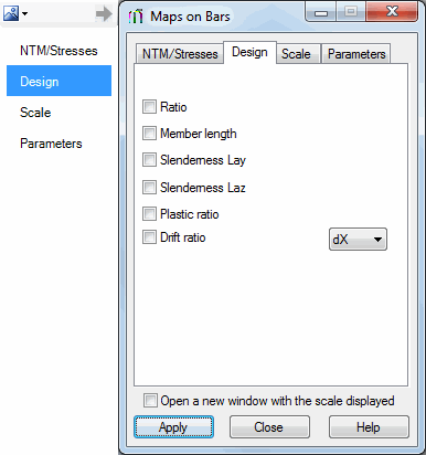

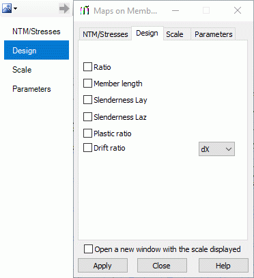

To support a large number of tabs, some dialogs have tabs along their left sides. For example, the Maps on Bars dialog.
To expand the tabs on the left of the dialog, click
at the top left of the dialog. To collapse the tabs, click
Click
to open a submenu where you can specify the degree of transparency (none, low, medium, high) for the tabs on the left.
