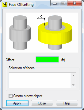

The option changes the position of object faces (offsetting). Using this option results in offsetting the entire face surface by the specified distance with respect to the initial face position. The diagram in the dialog shows how the offsetting operation is performed.
The option is available using either method:
The option is available for the following structure types: shell and volumetric structure. The option is available if Solid Modeler is installed.
To offset object faces :
If the Create a new object option is selected, the resultant object is assigned a new number.
