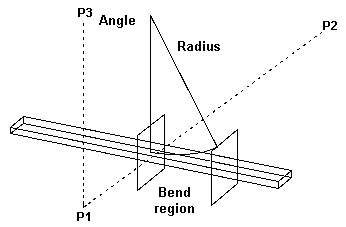

The option is used for bending an object around a defined axis. The option is available using either method:
The option is available for the following structure types: shell and volumetric structure. The option is available if Solid Modeler is installed.

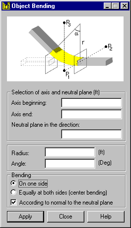

To bend a selected object:
In this case, the neutral plane passes through the origin of the area to be bent. (After the operation, the origin remains unchanged).
For this type of bending, the According to normal to the neutral plane option is available, which determines the part (side) of an object to be bent. The following image shows what happens situation when the right part of an object part is bent (according to normal to the neutral plane).
In this case, the neutral plane passes through the center of the area to be bent. After the operation, both the origin and the end of the area are bent. For this type of bending, the According to normal to the neutral plane option is not available
