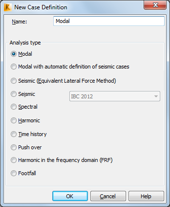

Click Add a New Case in the Analysis Types dialog to open The New Case Definition dialog. This defines new dynamic cases within the structure.
The following analysis types can be defined in the dialog:
To define an analysis type:
The seismic analysis according to the equivalent lateral force method is independent from other cases and doesn't require a modal case defined before.
Select Modal with automatic definition of seismic cases option to simultaneously define a modal analysis case (with definition of modal analysis parameters) and a seismic analysis case (with selection of a seismic code and definition of seismic analysis parameters). Select the Modal with automatic definition of seismic cases option to open the Modal Analysis dialog.
Below in the dialog are options representing 2 types of structure analysis:
If modal analysis of a structure is not defined, dynamic structure analyses (seismic spectral, spectral analysis and time history) are not available. For spectral analysis, seismic analysis and time history analysis, use the results obtained during modal analysis of the structure. The definition of parameters of this analysis has to be preceded by the definition of a modal analysis of a structure. You can define several cases of modal analyses of a structure, each defined by a different set of parameters (differing mass matrices, damping values, and others). Seismic spectral, spectral, time history analyses carry out for the parameter defined for modal analysis, which is located in the list of structure loads.
